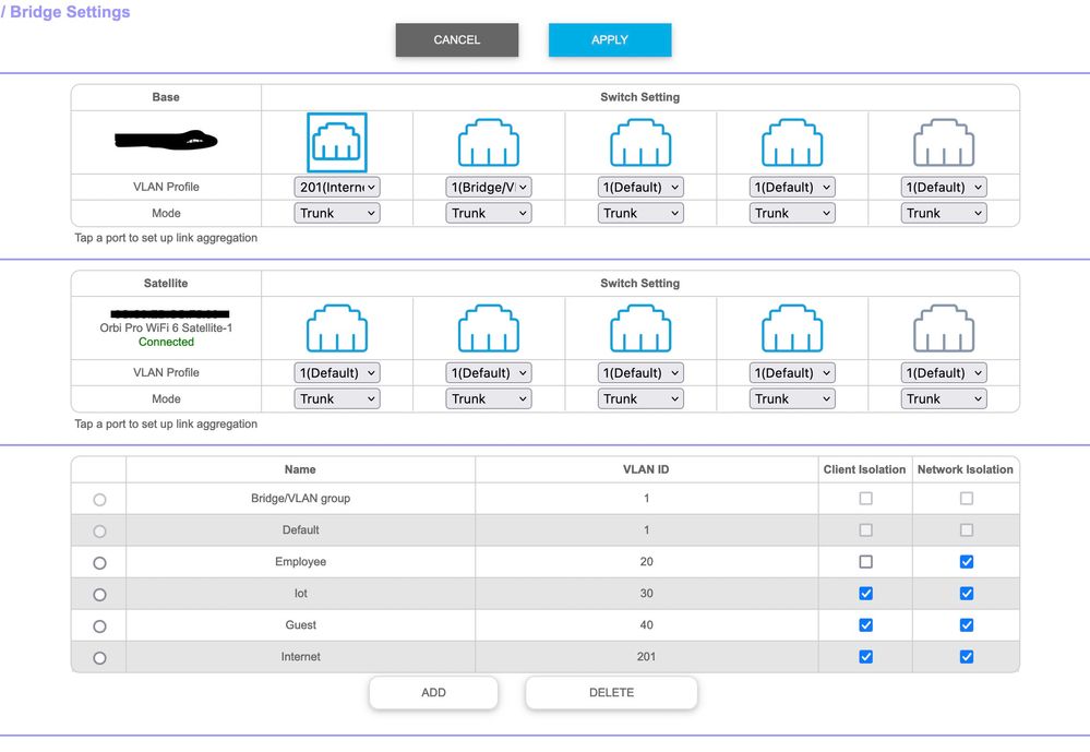

- Bnjmn22Aspirant
This is what my VLAN / Bridge settings look like now.
It works, but problem is that I think now its in wireless mode as the connection is rated as "fair" and my ping/speed seems slower than my RB853

- Bnjmn22Aspirant
Update,
I installed the new 4.0.0.118 firmware and I see the Bridge/VLAN tag I was using is gone. Now, there is an IPTV one I set to 201, and then I set the WAN back to 1/default and it does not connect to internet. However, when I set WAN to 201, a custom ID I created, it works but the satellite is not working again.
Also no lan ports are connecting to the internet either.
