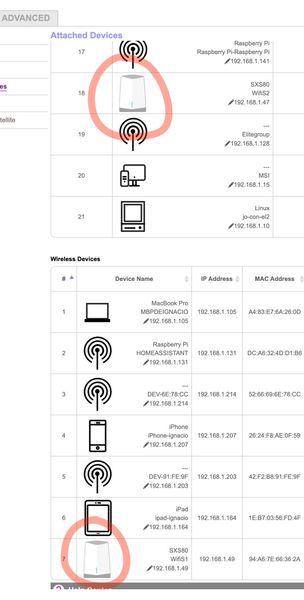

Orbi Pro SXS80 does not connect wired with router
Hello, and thanks in advance for the help. I've one SXR80 and 3 SXS80 satellites. All updated to latest firmware V3.2.6.102 and all of them connected wired to the ethernet network. The network co...

Just to confirm, are the three satellites connected to the same Cisco switch?
Also, you may try performing a Reset on that satellite having an issue or changing its network cable to see if that'll resolve the issue.
But if the issue still persists, you may try directly connecting the affected satellite to the router if possible.
If all else fails, there's a possibility that there might be a problem with the satellite itself and I suggest to contact our NETGEAR Support Team for further assistance here.
