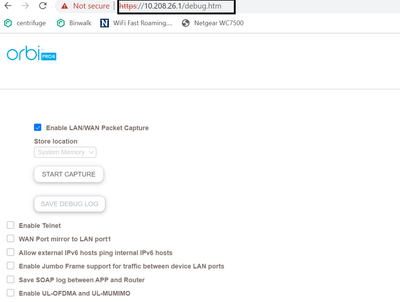

  • Hi Mstrbig
    Could you please share the debug logs from both Root and Satellite for further analysis.
    Debug logs
    <IP address of Root/Satellite>debug.htm, please refer below screenshot.
    Click on "Start capture" option to capture debug logs.
    When we click on "backup" it will save in your local system. may be downloads.
    Please find the screenshot for more information.
    Thanks,
    Basavaraj
