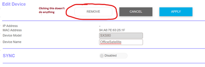

I have an Orbi SRK80 with what used to be 4 SXS80 satellites connected. One went defective and I disconnected it and returned it. However, I am unable to remove the satellite via the web GUI. If I go to Attached Devices, then scroll to the bottom, I can see the dead/disconnected/not even in my house satellite. Here's what it looks like, clearly showing it's not connected:
I click on the name/pencil icon to edit the device. The "Remove" option is grayed out (although a hand icon appears instead of the normal cursor arrow which normally indicates an interactable element). I've tried disabling "Sync", not that that would do anything since the device isn't even physically present or connected, hit apply, and tried again in case that was holding it back. Nope. Totally unable to remove the device. I'd try the Insight app but I'm not going to pay for a subscription fee just simply to remove a device that I had to send back because it was defective. Any ideas how to remove the satellite that's no longer even in my house NOT USING INSIGHT? Thanks!

  • Update: OK I broke down and bought the insight sub since it was $9.99/year. I tried to remove the satellite via the iOS app but it gives me an error when I click remove saying " "OfficeSatellite cannot be Deleted. Connected satellite cannot be removed."
    I have no idea how it thinks the device is connected. It's legit not even in the house. Yes, I've rebooted the router several times as well as turned it on/off again.
