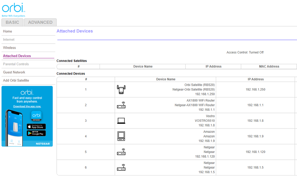

Ideas, thoughts?  I'm attaching a screenshot from within the Orbi RBR20 that shows attached devices, excluding MAC addresses.  Not sure if this helps, but wanted to try.

      I don't see a button that says "Connected Clients" and when I click on Attached Devices, the only options I have for that device since it's connected with an ethernet cable is to change the name and device type.  I'm not able to connect it via wifi at all.
