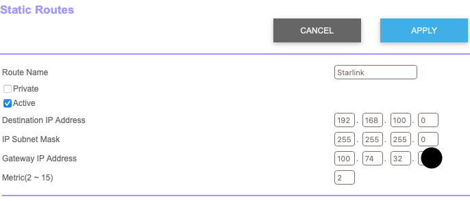

- Feb 21, 2021
I removed the LB2120 from the equation and the static route worked right away:
IP: 192.168.100.0
Mask: 255.255.255.0
Gateway: The IP assigned to the Orbi by the ISP
Metric: 2

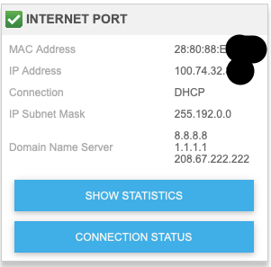

Hopefully this works for you. First shot is the Advanced home:Advanced
Second is the static route I set (Advanced -> Advanced Settings -> Static Routes:
Static Route to DishyJust repalce the Gateway IP Address with the one in the Internet Port -> IP Address and you should be golden. Note, if Dishy reboots the route will likely be broken as your IP address changed. Just Edit the route with the new IP, Apply, and bingo.
