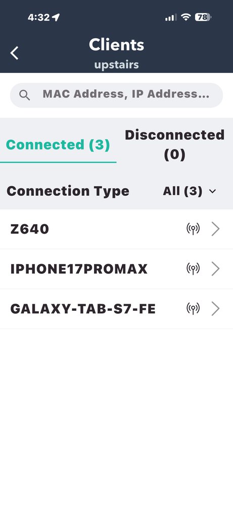

Just checking my SXK30 system, after getting it all FW v4.3.4.300 manually updated and did a full on factory reset and set up from scratch using a PC and web browser first, Insight app connected and giving that a few minutes, the app is showing devices connected with in the app for me. Though I only have 3 devices connected currently. Shows my iPhone 17, Galaxy Tab 7 FE and a ethernet connected PC.
I'll add some more devices over the weekend and check again.
Curiosity question, fellow FURRYe38 : On the App, do you see the list just when selecting the SXK30 device, or have you discovered any place wher you can list all connected devices for either a selected Location, or a button to list the connected devices for the current Location, an option to select all clients from a different Location, or a list of clients connected to All Locations?
Based on your screenshot showing Clients -> upstairs - theese are just the clients connected to your (single?) SXK30. Yes, I'm aware the Orbi Pro appears as a single device only to Insight.
From the classic Insight Web portal, there is a link for each connected location, where one can get a list of all connected devices on that single location.
Equally, there is no link to list All Locations connected clients.
This asking about the App (current update Android app). Thus asking the above questions.
