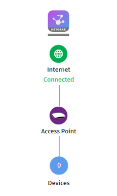

I went to manage my devices on Netgear Insight and discovered that only one of my devices shows as connected. Same for accessing insight from my tablet or from the web.
The ones I wanted to check were the WAC540 devices. One says it has been a couple of days since it last checked in and others say it's been almost a week.
I rebooted them and still nothing. They work and logging in locally shows they are connected fine to everything except Insight Cloud. DNS is fine. Ethernet connection is fine. Some are POE and some are external power. I can ping addresses on the internet and resolve hostnames.
They all have the same firmware. Odd that they are all like this but the one WAX610Y is working just fine. I rebooted it as well and it still shows connected.

Fascinating... I restarted my router and suddenly everything started working. All the WAC540 devices registered and show up in Netgear Insight again.
Otherwise my Internet has been working. There have been a few other odd devices that were giving me grief (a couple of tablets, all the Alexa echo devices and a couple of OctoPi devices). They worked for the most part but kept reporting Internet not available. The Alexa devices I had to power off for an hour and when I powered them back on they were fine.
Really strange behavior but everything is good now.
