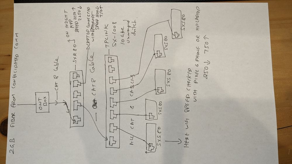

    How are the SXR80, the unmanaged switch (limiting the possibility of configuring multiple VLANs), and the SXS80 connected? Have some simple drawing at hand?

    • Sree420's avatar
      Sree420
      Thanks for taking an interest in this. Here is what the network looks like. I disabled all other SSIDs but the main one and vlan was disabled. I m checking speeds with speedtest app on my Google Pixel cell phone with adaptive connectivity switched off standing about 5-10 feet away from a SXS 80.

        Great! What concerns me a little bit is the note of the SXR80 direct ethernet connection making 500 down and 750 up, not just the wireless showing just a 250 down and 750 up. Unless we face the odd problem some customers face with a very similar Netgear switch reporting almost similar poor throughput results, e.g. Speed reduction with XS508M
        Something for Netgear to look into.
