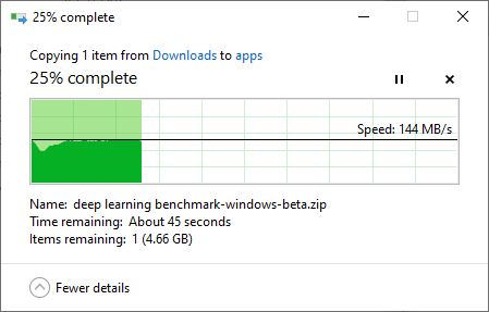

As long as the enclosure has notable issues that will cause it to drop to USB 2.0 mode, then assuming it is formatted as NTFS with no sector alignment issues, then depending on how full the drive is, your speeds should be somewhere in that range when reading or writing a large file to the router using Windows explorer.Here is an example of how transfers typically look for my RXE500, copying a file over using windows explorer.
In the screenshot (takes a few hours for attached images to be visible on these forums after uploading them), it fluctuates between 144MB/s and 147MB/s
Using a cheap orico branded USB3.0 SATA dock that I purchased from newegg for around $12 a few years ago.
