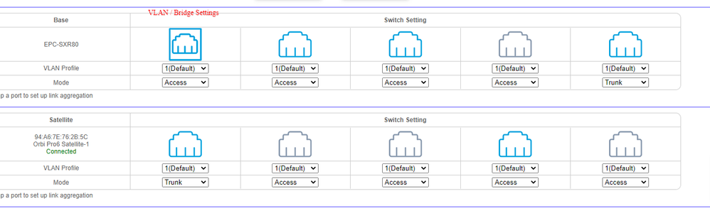

SXR80 is in one office. Then the SXS80 is remote and connected to the SXR80 via ethernet. I have the ports on the SXR80 and SXS80 set to TRUNK so the vlans are passed through for the different wireless SSIDs.
This is the current VLAN/Bridge Settings. Port 5 is going to the Satellites' port 1.
Here you see the satellite giving the client a 169. Instead of the 192. The client will start off on the correct IPv4, then after awhile it disconnects and assigns itself a 169 ip.

    Somehow I am unable to see the image that you have posted here. Could you please check and repost here?
    1. Can you tell us if your SXR80 is in AP mode or router mode?
    2. If SXR80 in router mode are you getting the IP address for SXS80 and not for the clients connected?
    3. Please send us your network topology and the debug logs taken from https://<ip address of SXR80/SXS80>debug.htm
