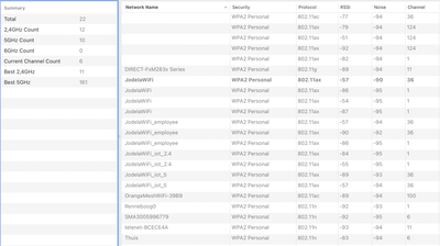

This is a scan of the networks. Also not much change going on there.
JodelaWiFi is mine.Router is behind ISP router. The router keeps having internet when all others fail (all wired connections just keep working). Model is CV8560E, no idea of the brand.
