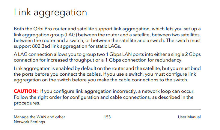

And no, it won't limit the Internet speed to 1G, check the wonders of a LAG.:

For the router, if port 2 is set to WAN (which is limited to 1G), and you connect your modem to that port, then I don’t see how your internet speed would not be limited to 1G…? I know what LAG is, but I don’t see how that would come into play. Or do you mean that you would have your modem connected via two Ethernet cables to port 2 and 3 on the router, and then bind those ports? But even if you do that (which I don’t think would work), then LAG doesn’t increase speed for a single device (and doesn’t work with WAN?), it only increases the throughput when using multiple simultaneous connections/devices. So you would still be limited to 1G in either case..?

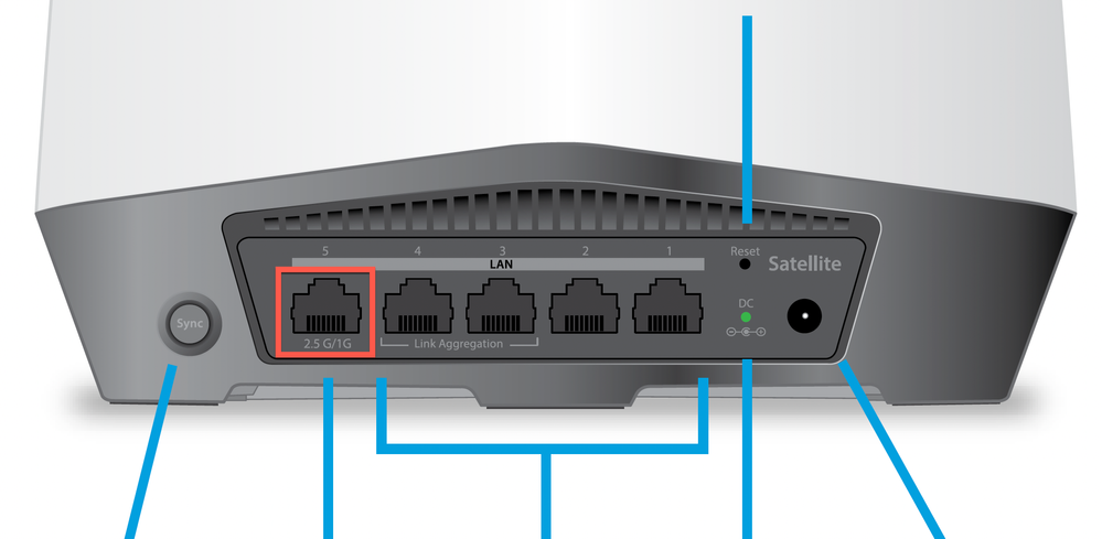

By the way the SXR/SXS80 quick start guide labels the ports a bit differently. The text description talks about port 2-5 being 1G, and the image shows that the ports are numbered in reverse order (from 5 to 1). To clarify though, I am trying to connect the NAS (10/5/2.5 GbE) to the port on the left side (which I have been referring to as "Port 1" in this thread), which is labeled as "2.5G/1G". So the port highlighted in red in the attached screenshot is only providing a link speed of 1000M in my case.

no, of course not. Major ISP (CPE manufacturer) as well as Netgear are have devices - cable modems and routers - in the market allowing to use two GbE links in a LAG providing aggregated bandwidth to the Internet router >> 1 Gb. It's just a question on how the LAG members are distributing the traffic over the ports. There a no algorithms defined in the "IEEE 802.1AX-2008 IEEE Standard for Local and Metropolitan Area Networks – Link Aggregation", all it say is:
This standard does not mandate any particular distribution algorithm(s); however, any distribution algorithm shall ensure that, when frames are received by a Frame Collector as specified in 5.2.3, the algorithm shall not cause
a) Misordering of frames that are part of any given conversation, or
b) Duplication of frames.
