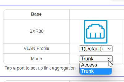

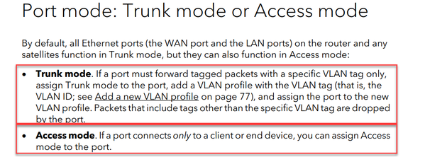

    Additionally, you can use one port, and specify multiple VLANs, on the SXR router.
    So, you can specify it as a trunk port, and that carries all your VLANs. See the documentation, to give you some more detailed explanation: https://www.downloads.netgear.com/files/GDC/SXK30/SXK30_UM_EN.pdf - from page # 88.
