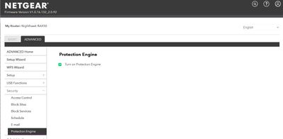

Hi ,
Can someone explain what is the "Protection Engine" that i found in web management of my RAX50 Router ?
It seems not related with Armor.
Connect with cable and with this option enabled the ping to my router is between 3ms  to 5ms
With this option disabled ping to my router ip is fixed 1ms

       I dont't know if this option came in the last FW update or was already there. The default seems to be ON
      From my testing is not related with Armor . I have a valid Armor subscription and with that flag on or off does not seems to change anything in Armor
      The only evidence is that the ping is much higher if the flag is on
      Switching on/off the router apply immediatly wiout reboot or waiting but suddenly the ping time change

      Hi i tested last FW and this optIon in last days and :
      1) I had some problem with previous FW 1.0.15.128 with UI crash and UI not reachable . All instability problems seems fixed this new FW V1.0.16.132 and now RAX50 is rock solid
      2) The  "Protection Engine" option interfere mainly pinging  the local interface. Pinging outside to internet seems not interfere so much. Very difficult to understand this behavoir without details
      I have a 1000/500 Mpbs fiber connection and overall speed in upload/download does not change
      As result of these testing i think that this new FW is very good and i left that option enabled .
      Disabling security feature is never a good idea if  does not interfere too much on overall performance

        Why in the hell would Netgear think it would be acceptable in any capacity to silently deploy a "feature" called,  "Protection Engine" to residential customers across the world? Especially knowing the adverse side-effects? I understand Security comes before Performance in business, commercial, and enterprise environments... but I mean, hey, it'd be nice to be notified at the very least?
        Thanks and good luck everyone. I'll update this post later today with before/after screenshots. It's currently 3:30AM, I need to get some sleep. Also, for what it's worth:
        • Router Model: Nighthawk RAX41
        • Firmware Version: V1.0.16.132_2.0.92
  • I’ve been fighting issues with devices on my network needing to communicate locally with eachother for months, if not a year. It finally clicked it probably started when I got my netgear router. I’ve noticed I can print to a wireless printer if my computer is on Ethernet, but it’s extremely rare if it works with laptop on WiFi. Same with my phone. Sometimes will find printer but usually won’t. Same with lan mode on a 3D printer. And having issues with security cameras not saving clips to a local storage device. Today, I found protection engine was enabled. Disabling it solved all my issues. It really ticks me off that this feature which has 0 meaningful description has caused so many problems in the name of security. I can’t even submit a support ticket to netgear without a subscription, WTF! I thought this was the best place I could share my experience. Hope it helps someone.
