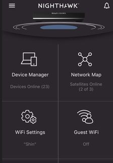

      I was able to reproduce this issue today by uninstalling and reinstalling the App:

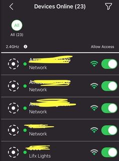

         After the installation, the app became normal ***for a short period of time*** - The connected devices showed up under "Network Map". And under "Device Manager", I was even able to see which mesh device my devices were connected to.

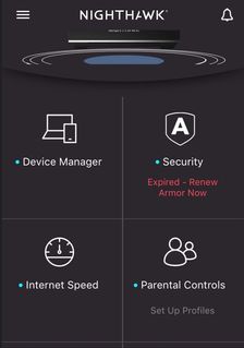

      HOWEVER, when I opened the App a few minutes later, something changed and the problem happened again. I was able to notice a few nuances:
         1) When opening the app, there were a couple of pop-up screen asking for subscription - this isn't a surprise I guess, but it did not appear right after I installed the app.
         2) The layout of the dashboard items has changed!!! New notification dots showed up in the dashboard for: "Security", "Internet Speed" and "Parental Control". "Security" also has a expiration warning.

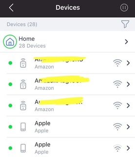

         3) "Device Manager" now has a white background (used to be black), and its default name is "Home" (used to be "All"). I can NO LONGER find which mesh device my devices are connected to!!! HOW COME???
         4) The main problem - Network Map no longer shows connected devices.

      Right after the installation (when it's normal):
      A few minutes later when opening the app:
