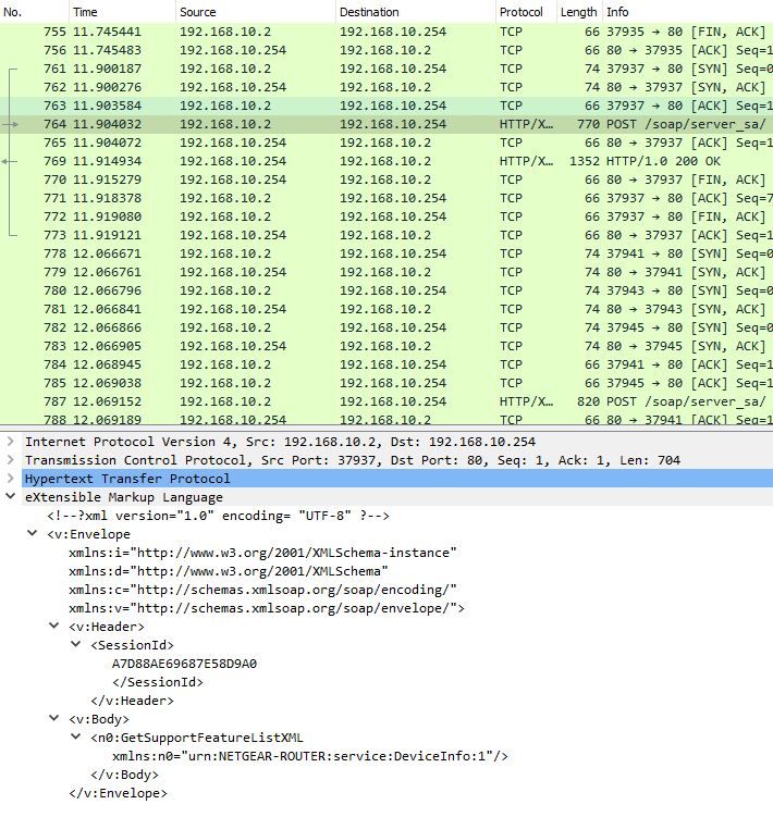

        Not very difficult to figure out - plain text HTTP SOAP - .2 is the mobile, .254 is a Netgear R9000:
        This applies even to Nighthawk routers supporting https - while the https://routerlogin.net/ is encryted and the certificate is trusted all firmware at least of a similar generation) does come with the very same certificate - and private key.
        Now, for most deployments - leaving e.g. Orbi with a wired backhaul out of scope - the mobile device App does connect direct over the already encryped WPA2 link (or WPA3) unless the admin has configured something silly with the router. So what's the fuzz here - it's just consumer junk anyway?
        On a broader IT security view, it's more essential how the encryption is done, how the keys are exchaned, how the keys are generated, ...
        PS: For somebody keen to know it won't be difficult to figure out discoving the same insight - not much criminal energy required.
