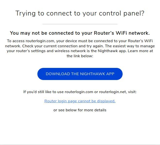

        I started over. Reset device, got nighthawk app. It went through all the initial steps including a firmware update and started configuring. Then it stopped and said "router not found).
        If I try www.routerlogin.com I just get to netgear's page, not to the router. It says:
        Below that it says:
        • If you are using NETGEAR Business products (any WAC or WAX access points or Orbi Pro), please visit APLogin
        • If you’d still like to use routerlogin.com or routerlogin.net, visit the Router login page cannot be displayed.
        • If you are using a VPN connection or a customize IP range, type your Gateway IP address on the browser to access your router. The default gateway IP for your router is 192.168.1.1.
        Doing a network scan, there is no device on 192.168.1.1
        There is a device on 192.168.1.180 but browsers will no open anything at that IP.
        I can't find anything on Netgear's pages that says "i don't have a compatible smartphone".
        So at this point I still have no clue.
