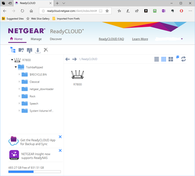

As guidance, here is what I see in my local browser:
That is with a 1 TB Toshiba USB drive. NTFS formatted.

BTW, when I log in to ReadyCLOUD, mine looks ‘similar’ to the image you posted EXCEPT all I see are the Router icon and a single folder Image. No other folders/files are shown below that single folder image. If I close click the router, it changes to a folder, and if I then click that folder, it changes back to the router image.
In other words, I can’t see what is in the Share folder! As your image indicates that you can.
