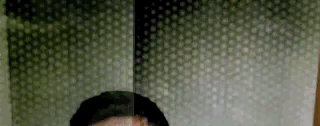

Screen Started flickering randomly. Service centers?
Has anyone encounterd their frame glitching like this.  As soon as the power is plugged in it instantly starts flashing.  Frame has not been dropped.  Seemed to happen while hanging on the wall.  Firmware is up to date. Could this be caused by power surge?
Also would like to find a service center for these frames based in Toronto Canada if anyone knows of one.
the screen flickers like this as soon as it has power
