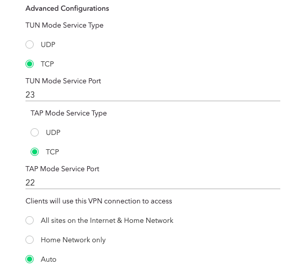

    My engineer is not able to ping to Jetson Orin Nano machine in my network even though the VPN service is running and configured below.  He is on VPN client.  I can see in the logs
    [OpenVPN, connection successfully] from remote IP address:196.217.135.174 Monday, Jan 19,2026 15:15:44
    However he is still not able to ping the Jetson or another Linux in my network.  You told me last time that I should not use 22/23 and I should switch to UDP for performance reasons.  Are they related to the Ping (Request timedout) issue?
      Could be.  I think the question is whether you actually have a functional connection to your home network.  Also, if you are using TUN, then I suggest trying TAP.
      Can he ping any devices on the network?
      Also, is he using a remote network?

    I guess there is no harm in changing the port number to 22 (ssh) and 23 (telnet), but it is a bit goofy.  I would be more comfortable staying with the default port numbers (12973 for tun - tunnel and 12974 for tap - network tap)  If the MR60 has telnet enabled, that might be confusing the OpenVPN Client.

    • StephenB's avatar
      StephenB
      acayci​:  Best not to use 22 and 23 ports for this.  Some places where you want remote access might block those ports.  So I also suggest switching back to the default port numbers.  If you do want to change them for some reason, it is best to use something in the private/non-reserved range (49152-65535).
      Also, UDP usually gives better performance than TCP for VPNs, so unless you really require TCP, I suggest changing back to UDP.

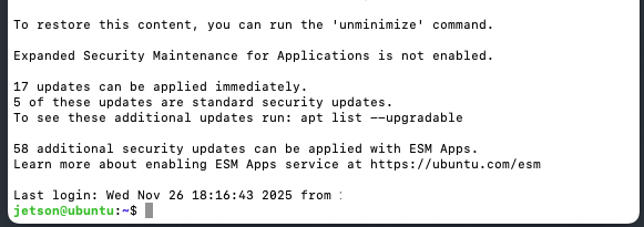

      Success!
      I was able to connect using OpenVPN Client.  Here is ssh to my Jetson Orin Nano.
      Mustafa
  • I tried to test the ports from my Macbook.  I was able to telnet to router port 23 but not 22.  Am I confusing myself?
    nc -vz <router_ip_address> 23
    Connection to <router_ip_address> port 23 [tcp/telnet] succeeded!
     nc -vz <router_ip_address> 22
    nc: connectx to <router_ip_address> port 22 (tcp) failed: Connection refused
    • StephenB's avatar
      StephenB
      Maybe.
      The VPN tunnel uses one set of ports, the applications use a different set.  If you are accessing services on the NANO (like Telnet), that application traffic goes through the tunnel.  Both TCP and UDP will go through that tunnel.  The ports used by the applications (22,23, whatever) are NOT the same as the ports used to create the tunnel connection.
      So you want to use
      1. the default ports for the both TAP and TUN in the OpenVPN settings on both the router and the OpenVPN client on the Macbook
      2. UDP for the tunnel itself (whether you are using TAP or TUN).
      Once the VPN tunnel is established, you connect to the Nano using the same commands you'd use at home.  So just run ssh from terminal to check it (or your usual telnet client if you want to use telnet for some reason).
      You can't really test this with nc when the MacBook connected to your home network, because you can't tell whether the traffic is going through the tunnel or not.  It is best to set up a hotspot on your phone, and then connect the macbook to your phone - so the traffic runs over the internet through the phone's mobile data connection.
  • StephenB's avatar
    StephenB
    Did you remove the previous openVPN config?  (the one that used TCP).
    • acayci's avatar
      acayci
      Tutor
      No.  I am still using the configuration that uses TCP.
