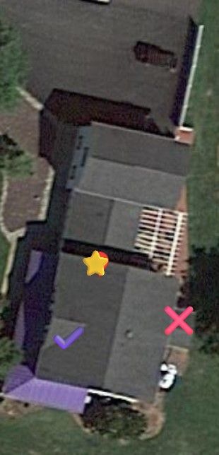

Hello everyone. For a while i have been noticing deteriorating speeds so recently I decided to start running speed test and what i found was scary. So for my Router I have a Netgear CM1150V (I have Comcast/Xfinity as my ISP). For my router I have the Netgear MR60 and 2 satellites (MS60). Now I pay for 1G download and on the Netgear App it does show that the Main Modem (MR60) it gets like 960 down and 24up. (attached is the picture of the layout, STAR is where the MAIN modem is at MR60 (1st floor), the Red X is where one of the MS60 is at (1st floor), and the purple Check is where the 2nd MS60 is at (Basement). I installed Wifi Analyzer (Android) to see if maybe it was a channel setting issue. Below is what i found.

Laptop WiFi next to my Kitchen on 1st floor next to MS60 (Red X) I was getting 195 Down (5Ghz Channel 149)
Laptop next to Basement MS60 (Purple Check) on WiFi I was getting 247 Down (my gaming PC connected to ethernet to that basement MS60 i got 406 Down)
now on the 2nd floor which is the area of the Purple Check (but purple check is in basement, 1st floor, then 2nd floor) I an getting about 65-75 Download... it has been VERY inconsistent, I have since grabbed the basement MS60 and connected it on 2nd floor (still where purple check is but now on 2nd floor) and in my room i'm getting 92 Download. I have swapped Ethernet cables between modem and router (despite MR60 showing its receiving 900+ Down from Modem

What is the distance between the router 📡 and satellite(s)🛰️? 30 feet or more is recommended in between RBR 📡 and RBS 🛰️ to begin with depending upon building materials when wired or wirelessly connected.

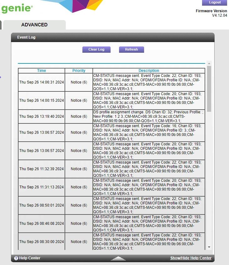

Please post a copy and paste of the modems connection status and event log page.
https://kb.netgear.com/30007/How-do-I-obtain-the-cable-connection-information-from-a-NETGEAR-cable-modem-modem-router
https://kb.netgear.com/30008/How-do-I-view-or-clear-the-event-logs-on-my-NETGEAR-cable-modem-or-modem-router

What is the distance between the router and satellite(s)️? From Main one in the center of the home to one in kitchen about 30-40 feet . from Main MR to MS on 2nd floor about 30-40ft.

Can you post the cable connections status page data please:
