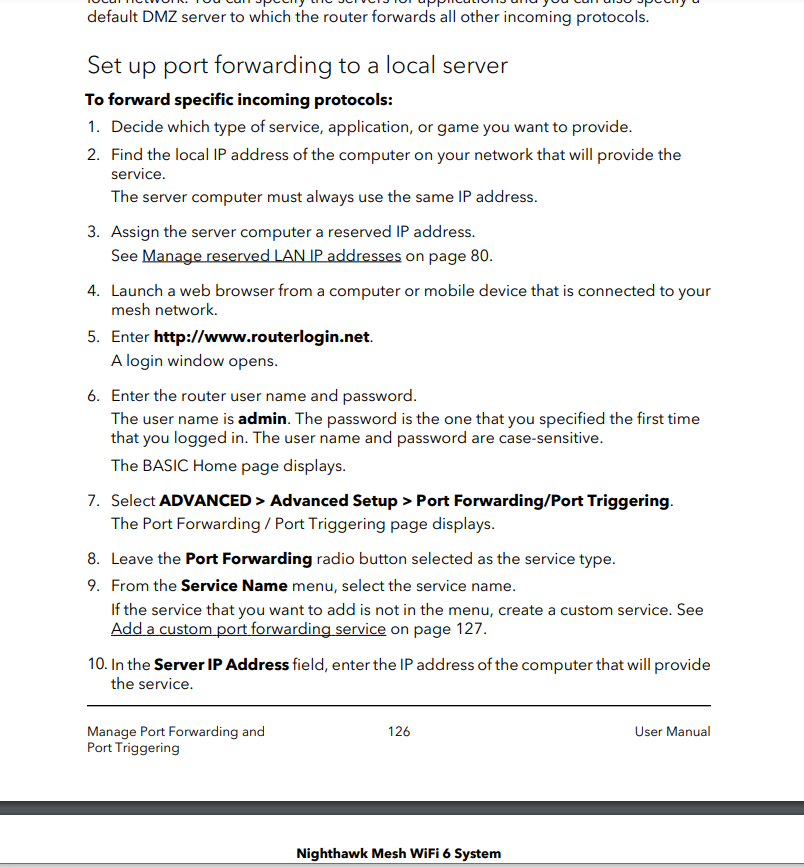

    Don't worry, it hast it  - certainly as long as the MR60 is in Router mode:
    ADVANCED > Advanced Setup > Port Forwarding/Port Triggering
    Usually consulting the fine documentation helps: https://www.netgear.com/support/product/mr60#docs
    Nighthawk Mesh WiFi 6 System Router Model MR60 and Satellite Model MS60 User Manual p.126 ff.
    Correct Server LAN IP address in place?
    Correct protocol and port configured?
    Double-checked the ISP does assign a route-able IP address to your MR60? (Advanced Home - Internet Port - IP Address) - an not a Carrier-Grade-NAT IP Address or Private Internet RFC 1918 Address assigned?
    No firewall rules prohibiting access the server LAN IP from the wild Internet?
    UPnP enabled, and some unwanted UPnP-configured port forwarding rules in place?
    ADVANCED > Advanced Setup > UPnP.
