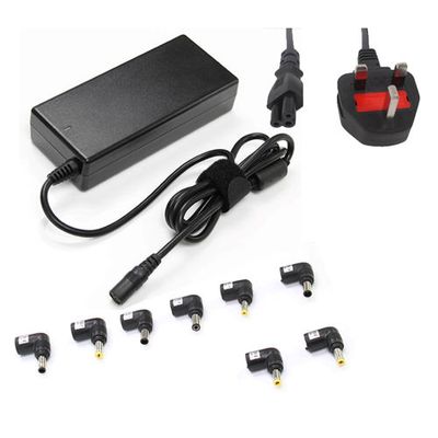

    Netgear does not sell replacement power adapters. Any generic transformer will work, as long as it has the right volts, enough amps and a tip with the right (+/-) polarity and dimensions. (Look at the label on your device or the old adapter.)
    These things are pretty common, so first check to see if you have something compatible lying around.
    Look at  the label on the device itself. The manual says 12V, 1A DC output the data sheet says 12V/1.5A power adapters.
    Some web stores will even claim compatibility with Netgear devices. There may even be a retail outlet near you.
    Some generic adapters come with a set of tips that will fit a range of different devices.
    Generic adapter
