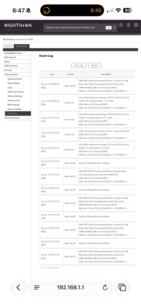

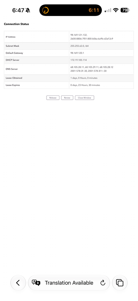

        The event log recorded Dynamic Range Window violations, upstream profile changes, commanded-power adjustments, and one synchronization failure/loss-of-sync event during the several minutes immediately following the CAX80 factory reset and reprovisioning. The modem subsequently reported a good connection and received valid IPv4 and IPv6 addresses.
        A direct Wi-Fi test through the CAX80 measured 1,112 Mbps download. I then returned the CAX80 to modem-only/bridge mode.

        The current wireless settings are Auto on 2.4 GHz and channel 44 on 5 GHz. I have restarted the monitoring script and will leave the configuration unchanged. If the degradation returns, I will capture the MR80 internal test, direct MR80 Ethernet and Wi-Fi tests, MS80 Ethernet and Wi-Fi tests, router uptime, and backhaul status before rebooting anything.
        Screenshots of Event Log and Connection Status are from after CAX80 reset and before entering bridge mode.
