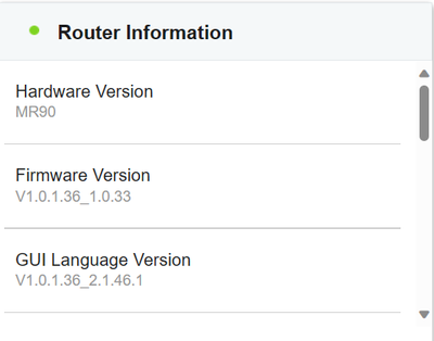

    • LRoller's avatar
      LRoller
      No problem,  the router firmware V1.0.1.36_1.0.33 connected to a Spectrum Modem model ET2251.
      • LRoller's avatar
        LRoller
        Forgot to confirm the modem is not also a router.
