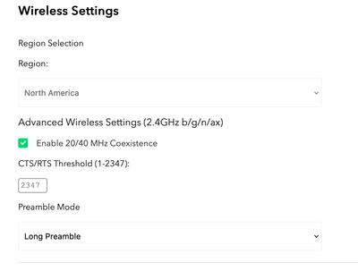

Any Wifi Neighbors near by? If so, how many?Set 20/40Mhz Coexistence to 40Mhz only. Save settings and reboot the router and satellite(s). Under Advanced Tab/Advanced Settings/Wireless Settings

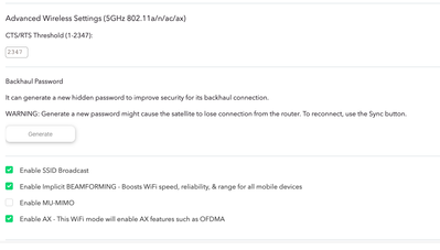

I see the following, please let me know if that is what you meant.
Thank you very much for your help!

Yes on the 40Mhz, uncheck the box and apply the change.
Try enabling MIMO as well.
