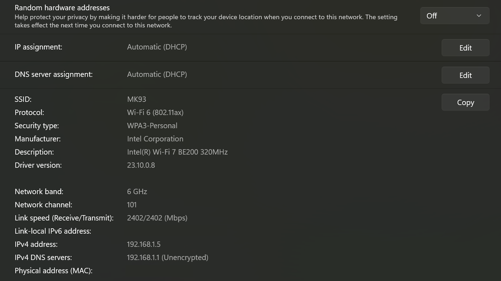

    • FURRYe38's avatar
      Manually updated my MK93 system.
      Looking good. Even with a BE200 PCI card:
  • So far, performance is still good with an Intel AX210 client reaching about 1.7Gbps real world throughput when transferring data from a wired client connected to the 2.5GbE port.
    5 and 6 GHz band give about the same performance.
    Will have to do some longer term testing to see if performance is maintained after it has racked up a few weeks of up time.
