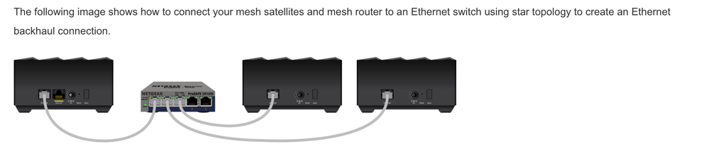

And even in URL you provided it is showed as it will work in star topology.

That is the right topology. And if you connected the MS in that configuration, then your MR would be connected to the host router using the MRs Yellow WAN port. The yellow WAN port IS needed to connect to the host router while in AP Mode. I've had my MK systems in AP mode as well before in this configuration it works. Give it a try.
Ya, The MR has limited ports. So get a NON Managed LAN switch in between the MR and MS as shown in the picture. I have several on hand and all work well.
NG GS-105/108v4 and GS308v3, D-Link DGS-105/108 and HP ProCurve 1400/1800 series switches work for MK systems.
