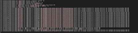

Nighthawk MK73 - AP Mode Satellite won't sync
I have a Nighthawk MK73. So first unit MR70 was configured in AP mode, when i'm trying to add satellite MS70 that is connected via ethernet cable it won't sync always get satellite timeout on the M...
