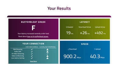

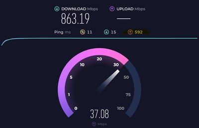

Bufferbloat, Lag, ETC... Nighthawk PRO XR1000
Hi All, I was hoping to get some assistance. I'm constantly dealing with issues of packet loss, and feel a notable delay in hit reg while FPS gaming. After a lot of experimentation and 8+ Spectrum Visit I do not believe its an issue on ISP's side. My latest idea is an issue of my upload with bufferbloat. Its persistent with QOS on and off, various bandwidth allocation and traffic prioritization. From what I understood the XR1000 has a built in SQM, is it possible its not functioning? Any ideas would be great. Thanks.

What test results if you ethernet connect your test PC directly to the ISP modem or ONT?
How is the router configured for QoS and such? Where are the sliders positioned?
Test with QoS enabled and disabled to compare results.
Try testing with a different PC to compare results.

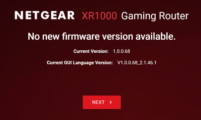

Be sure your using a good quality LAN cable between the modem and router. CAT6A STP is recommended.Try updating FW?
- Netduma-FraserNetDuma PartnerYou need to use Congestion Control specifically for this, how do you have this set and have you experimented with the percentages?
