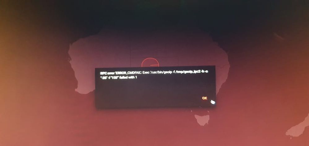

I purchased a Netgeat Nighthawk XR1000 and tried to set up geo filter but whenever I try to chnage radius and change my location cuz it does not point out my exact location an error message pops up. Can someone please help me???

- Netduma-FraserNetDuma PartnerI'm assuming the router upgraded the firmware during the setup wizard if so I would recommend a factory reset from the interface, wait 2 minutes and then access and set up and it should work. Reason being a factory reset clears out old low level code from the previous versions that could cause issues.
