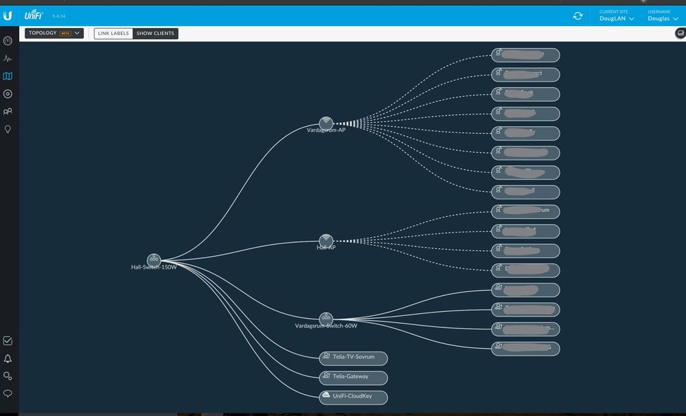

Maybe have a look at the way Unifi shows the network map, and adapt to suit :-)
