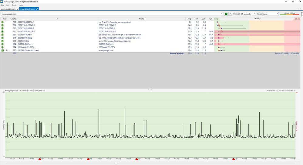

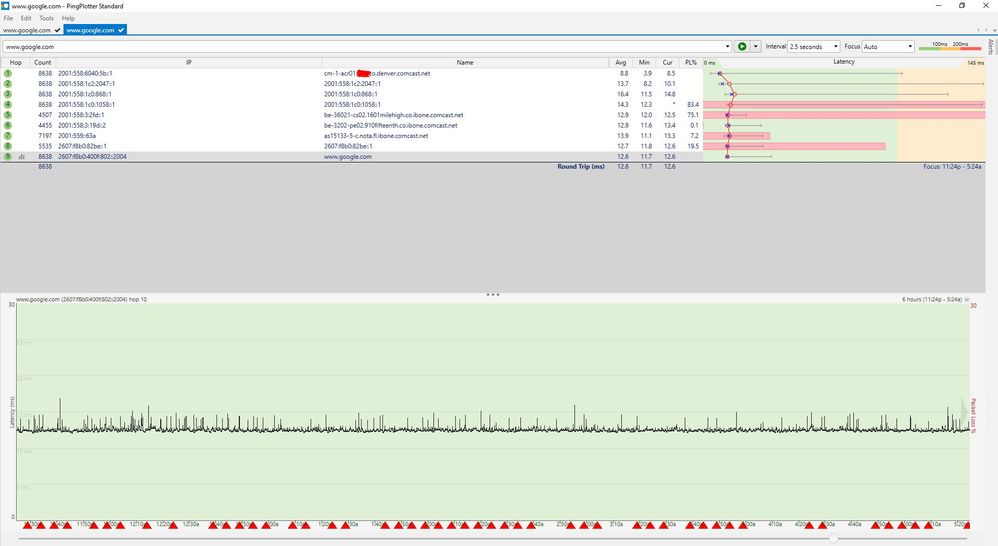

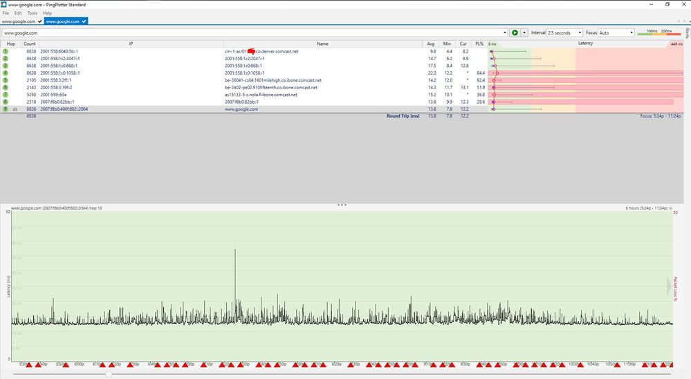

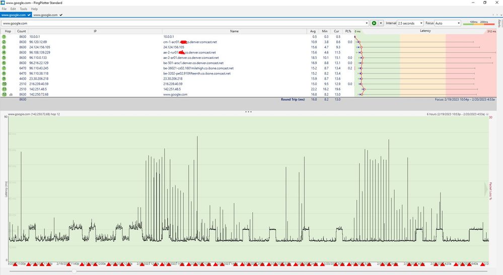

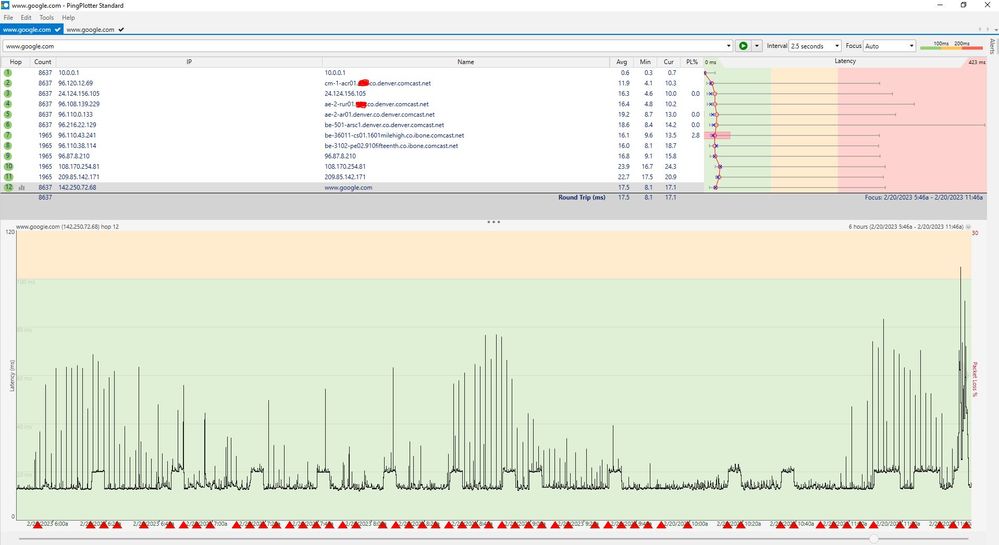

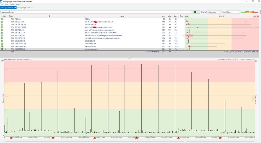

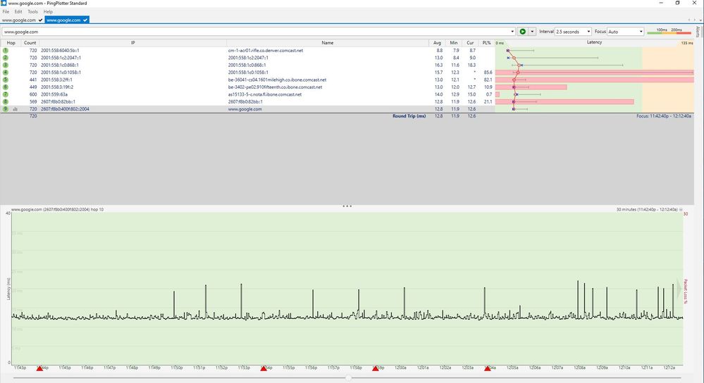

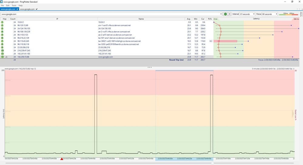

I am seeing large ping spikes that occur every 2 minutes, this lasts for about 75mins and then the connection goes to less extreme latency fluctuation for about 90 mins (odd baseline jumps), repeat. It is fairly consistent and there is definitely a pattern to it. You'll see from timestamps in the PingPlotter data that this happens no matter how much activity is on the router, i.e. 2am and occurs during and outside of "peak usage hours". This behavior doesn't seem to be the case when I connect directly to the modem, which leads me to believe something is happening at the router though I'm not 100% certain. Please refer to attachments for PingPlotter data.

At this point I am hoping someone can help me narrow down if the router is doing this, or if there is something wrong with how the modem is being provisioned and issues at the CMTS. I don't really have a reference for what is normal as I only started testing once issues came about a few months ago (noticed while gaming), this was around the time I got this new modem and router. I will say I have played some games on just the modem connection during the PingPlotter trace and didn't see or feel any noticeable issues in my connection while gaming. Contrary to where it is pretty obvious when I am connected through the router while gaming you can feel those ping spikes, even though they are brief.

- PingPlotter graphs the 6 hour views show latency on the graph incorrectly, as all green and under 100ms, but when you shrink the timeline view you then accurately see the spikes are 200ms +, more images are further down in the doc showing this
- Red strikeout in the PingPlotter images are my local city name
- I have the PingPlotter data exports of these traces if that is helpful but the attachment type is not allowed. Router connected- https://drive.google.com/file/d/1d7VFz2piDrk8J-PupnjnUqxwkUyHPqXQ/view?usp=share_link Modem only - https://drive.google.com/file/d/1aMBUsEsnxvkw5I2MSuooECSY97pJQjia/view?usp=share_link
Modem Info & Logs:https://drive.google.com/file/d/1AOeWzZ6Huj8KQEtCpfxDPrYlQTREcEik/view?usp=sharing
Router Connected 6hr view 1/2Router Connected 6hr view 2/2Router Connected 30min viewRouter Connected single ping spike with values at each hopModem only 6hr view 1/2Modem only 6hr view 2/2Modem only 30min viewModem only 30min view 2

The patterns your noticing do definitely suggest that the issue is in your line rather than the local router itself. The way to test this would be to disconnect the XR1000 for a few days (or however long it takes to reproduce the issue usually) and reconnect your ISP equipment. Play for a few days on your ISP equipment and check if you still notice the same behaviour. I suspect you will, as we can see from the Ping Plotter's that there's a lot of packet loss further upstream.
Take that info to your ISP and see what they can do to help. Sometimes providing things like Ping Plotter tests can be useful to them for debugging where the issue lies.

I contacted Xfinity and got a rental gateway (modem/router) from them. Sure enough seeing the same sort of latency spikes on their equipment. I have had technicians out here 3 times already and have replaced just about every connector and cable to no avail. I have another appointment scheduled for March 12th, so we'll see what they say at that point, the technicians seem to have done everything in their power at this point to help, so it may be a battle of getting the issue escalated. I have showed the technicians the testing on ping plotter when in my home, hoping this can get to a point where a network engineer on their side reviews the logs and can find and resolve the issue.
