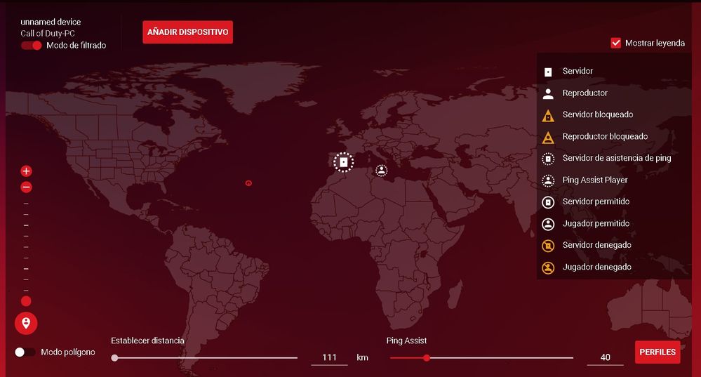

- Netduma-FraserNetDuma PartnerI can't see the guide unfortunately but can you provide a screenshot of the entire Geo-Filter of what you see when you're in a game please?
The guide indicates that you have to put the geo filter in the ocean with the minimum range to prioritize only by ping and not by distance, but it does not work for me, and when I do it with a geographic filter it is not that it improves me, I feel my latency the same, I have 1gb of download 1gb of upload
