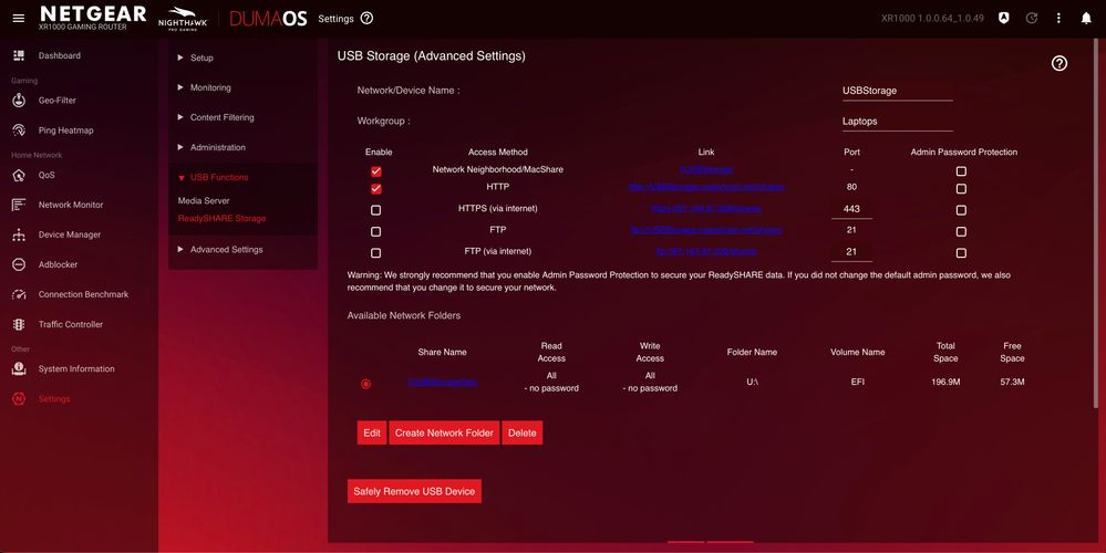

Posting here since Netduma does not handle ReadyShare troubleshooting.

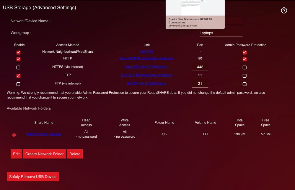

I have a NETGEAR XR1000 Nighthawk Pro Gaming Router and a compatible external hard drive (WD My Book 2 TB model WDBYCC0020HBK-NESN). I have reformatted it to exFAT using my Intel iMac desktop computer and I was able to connect it to my router. In the menu (Settings > USB Functions > ReadySHARE Storage) I can see that the total space is 196.9M, which is very much not what the capacity should be. I read that this can happen when some external HDDs are partitioned with two or more but mine is unpartitioned.

      When I checked the HDD there were no folders within it as I had reformatted it to AFPS (non encrypted). I then made a new folder named USBStorage and also renamed the HDD that:
      Seems like you might be right about this being unsupported. I'm hoping that the next one I buy doesn't have the same problem.

        I'm afraid we can't see that screenshot just yet as it's not been moderated. Perhaps try attaching it to the post instead of pasting it in?
        Are there any partitions on the drive that match the size your router appears to be detecting? If so, is that partition any different in terms of formatting etc to the one you're trying to mount here?
