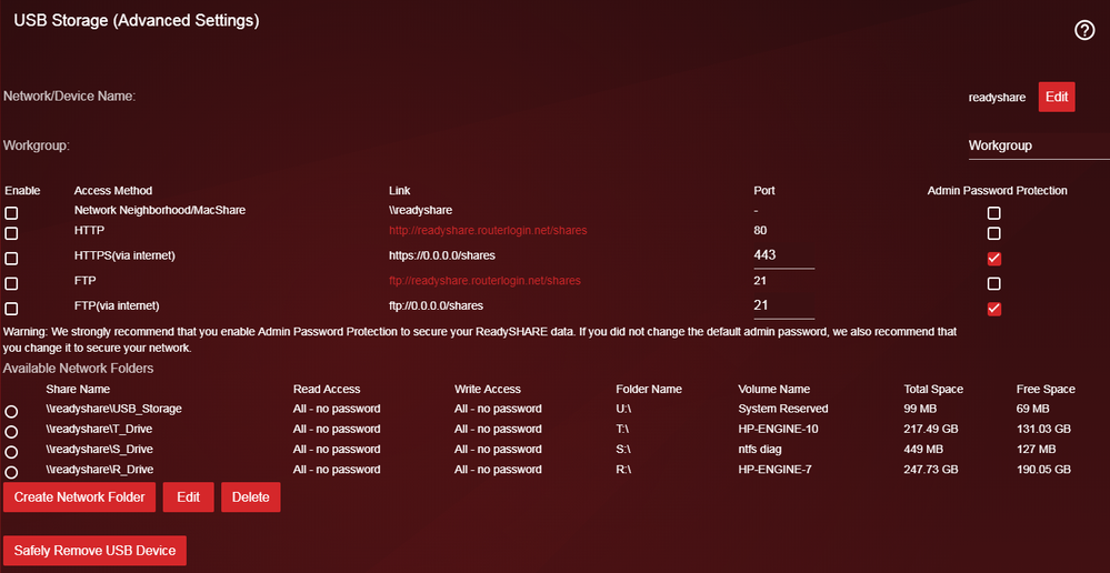

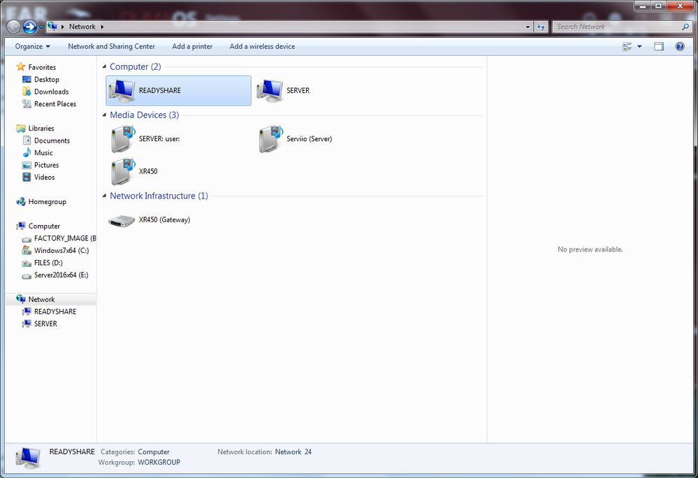

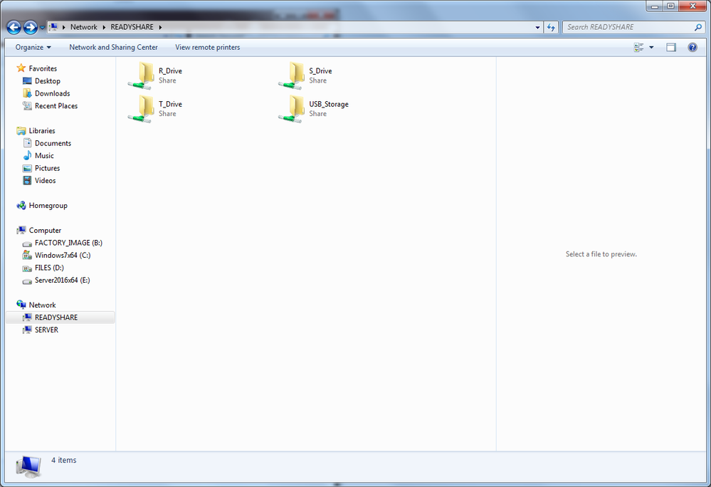

    Running Windows 7 and having a USB drive connected and enabled and ReadyShare enabled on my XR450 router:
    I get this result
    XR450 Ready ShareNetworking DetectedUSB Contents

        There  is no WSD server running in our router.
        Our Router relies on SMB 1/CIFS to discover the devices, if SMB 1/CIFS is disabled in windows 10, You cannot see READYSHARE in windows 10. (You should still can use Windows explorer access readyshare via \\Your Router IP address)
        In windows 7, SMB 1/CIFS is enabled, so it can be discovered (possibly by netbios provided by the samba server in our router).
