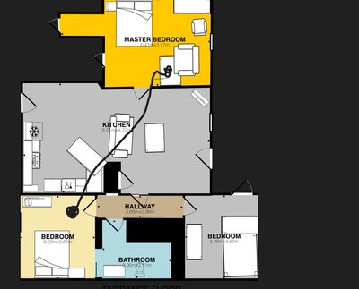

I have a XR1000 (XR1000 1.0.0.64_1.0.49) on one side of a 1200sq ft home.  Wired connection my speeds are 800-1000Mbps.  Wireless speeds within the same room as the router are 700-900Mbps.  Middle of the house same speed.  Other side of the house and the speeds drop to 30-130Mbps.  Printer's go offline randomly, all other devices on that side of the house experience low download speed. AX is enabled however I have tested with AX off, QOS and Congestion Control Off and On none of these settings seem to affect the speed.  We live in a rural area and I'm only picking up 3-4 networks in range.  This just started happening in the past two weeks and nothing has changed on my network.  The interior walls are thin and we haven't had this issue until recently.  Idea's on what to look for that might be causing this issue?  Router is in the Master Bedroom and the Affected equipment is on the other side of the house.  The house being smaller I'm not sure an extender is needed.

    but I do notice in your photo that it passes through the kitchen. Most kitchen appliances are made of metal and do a great job of blocking wifi. They could be blocking the signal.

    so it could be the progression of speed from distance and obstruction from kitchen appliances.
    If possible, I'd try centrally locating it. Would help as well

      I was wondering if a kitchen appliance could be affecting the speed.  I've tested on both 2.4Ghz and 5Ghz and the the 2.4Ghz is 30-130Mbps.  5Ghz is 30Mbps if the connection stays connected.  The 5Ghz connection (different Wi-Fi name than 2.4) seems to connect and disappear then reappear all within a few minutes.  I'm considering the extender if this might help address the problem.  The only working Coax connection is in the Master Bedroom so the router and modem are connected within that room.  What I can't figure out is what would cause the speed to drop suddenly in these past two weeks.

        Try raising or lowering the height of the router. Or even moving laterally 5-6 ft with a longer coax. Sometimes a slight lateral/horizontal move can help whatever was blocking.
