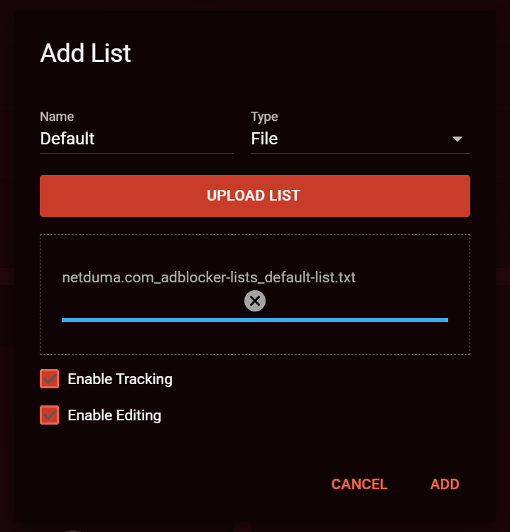

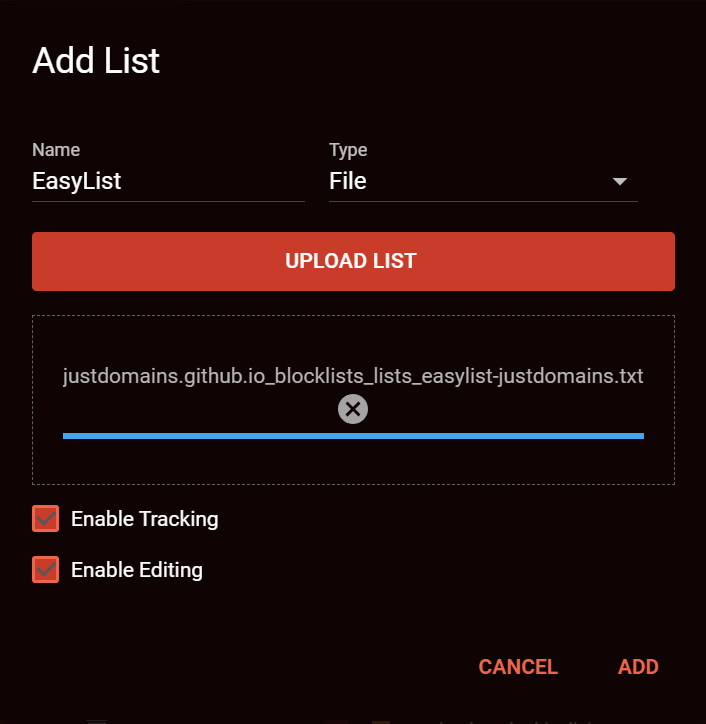

So I am trying to add adblock txt files I got from Github.
This type of lists
and I've tried domain only lists
But none of them can be added. The blue bar would go from left to right, as if it was finished uploading. When I click Add, nothing happens. It does not add the file to the list.
Is the FILE method also limited by file size?

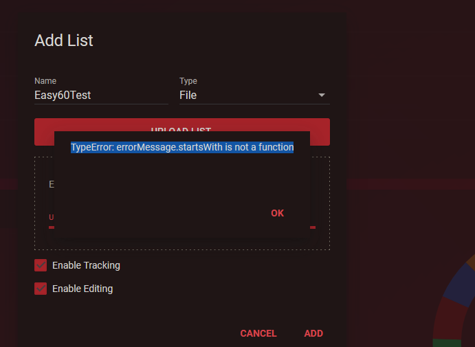

Trying to add them manually through file type 'Domain' I find that there's a character limiter, as I can only fit about 61-64 domains each time. This lead me to think maybe the file (.txt) is also limited to file size. So I've tried to make my own file with only 2 domains. I get this error. Then I thought maybe they need to be in "strings"; and end with semi-colons. That wasn't it either. I can't seem to Add Files. I get the error:  "TypeErrorerrorMessagestartsWith" is not a function.

      I think they're too big for the router and it's got itself into a weird state. Factory reset, add the default list we've provided, that should then work. Then from there, if you add files that are under 5Mb it should work without error.
