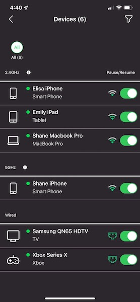

Weak WiFi signal. Signal strength doesn't go up even placing phone directly next to router or antenea.
2.4GHz device named Elisa iPhone was in same room with clear line of sight. Approximately  4ft away from router.
5GHz device named Shane iPhone was 1inch from router for testing. Even directly next to the router signal strength was minus 1.
EDIT: Not sure why the image isn't showing up. I attached the image as well.

  • Try these suggestions:
    Disable Smart Connect, give 2.4/5GHz different names and apply - you'll want to connect to 5GHz specifically for speeds
    Use a WiFi analyzer to find the least congested channel and change to that
    Set the antennae to this position _ | | _
