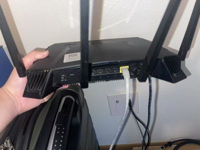

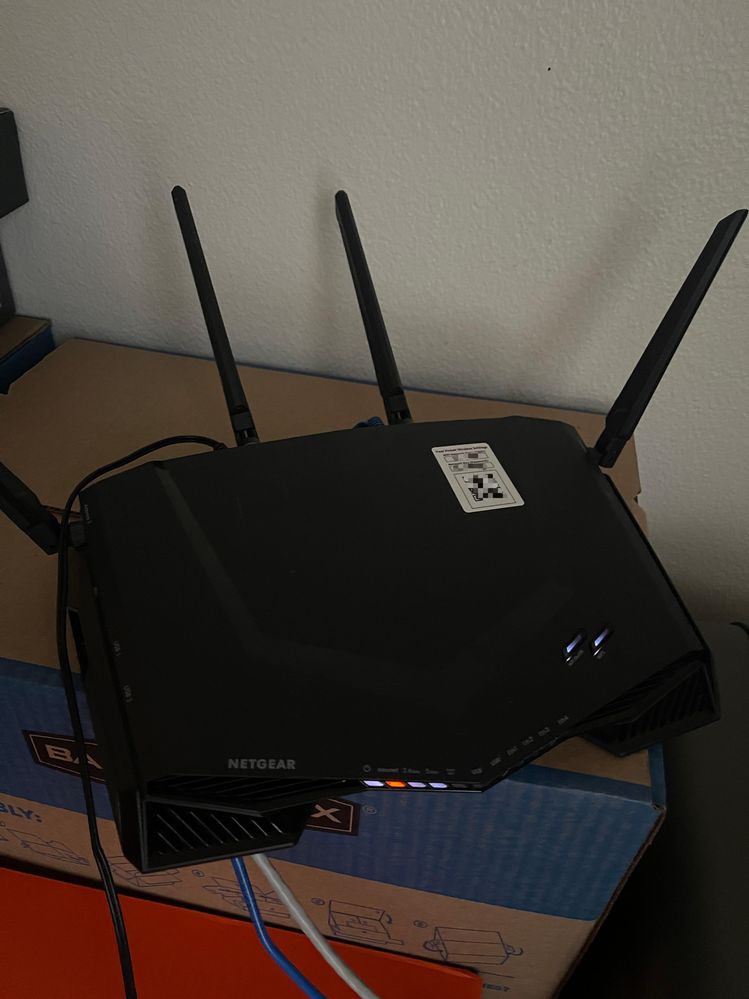

I just installed my XR500 Router and I couldn't detect the Wi-Fi signal. The status of the router is below. All the LEDs worked well and Wi-Fi switch is on. I have tried several attempts of reset, but still not working. Can somebody help me with that?

    For a start from the Internet LED it looks like you don't have an Internet connection on that router. Even so, the wifi should still be there.
    What are you using to detect the wifi?

      Thank you so much for your detailed reply. Well, both my laptop and iPhone cannot find the Wi-Fi signal. I also used the app to help me connect to the router, but it also failed because of the undetected signal.
      Since I can't connect the router with Nighthawk app or the browser interface, I'm then not sure what version the firmware is. Is there any way to update the firmware without the app or browser interface?

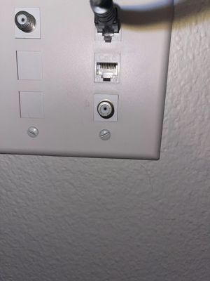

      The router is connected to the CAT 6 port of the apartment, which has no problem I think.
      I'd also look into previous cases that may help. Thank you again for your support.
        That makes it hard to diagnose your Internet connection. Those apartment networks may feed off of a router somewhere in the basement. So the usual modem settings may not work. You have to ask the landlord how to connect to that network.
        That doesn't account for the absence of any wifi signal. You should see the SSID network and default password on the label on the bottom of the router.
        You said that you have made several attempts to reset the router. Is this what you did?
        How do I perform a factory reset on my NETGEAR router? | Answer | NETGEAR Support
