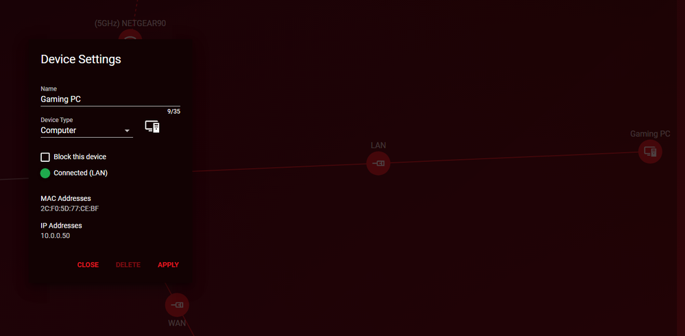

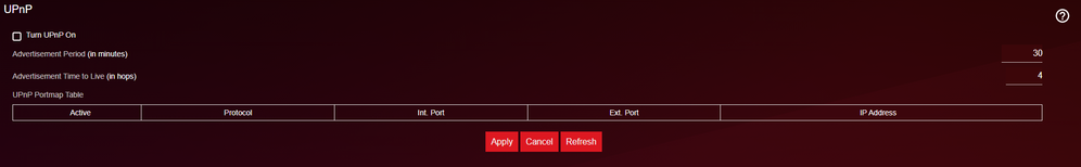

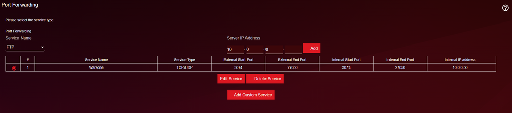

My network provider gave me router, in that i enabled UPnp, and added a entry for port forwarding. and as last step changing my IP to static. ie (192.XXX.X.X). My NAT Type was OPEN and worked like charm.
Got this new XR1000, Connected the XR router and the ISP router. Tried the same process by enabling UPnP, adding port forward entry, and my ipv4 addess was starting in 10 series. so updated my static ip address to (10.0.0.50). Not at all WORKING.

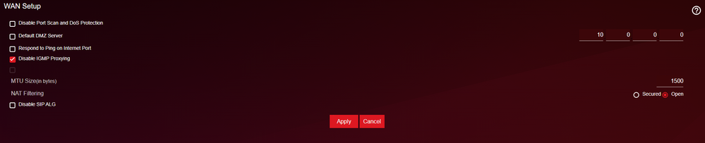

What I would suggest doing would be to remove your port forwarding rules, then put the XRs WAN IP in the ISP router/modem's DMZ. Then, make sure that IP is reserved for the XR in the ISP router/modem's LAN settings, this will ensure it doesn't change again in future.
After that, your NAT should be open.
- HammerSludgeAspirant
Thank you so much. It worked!!
