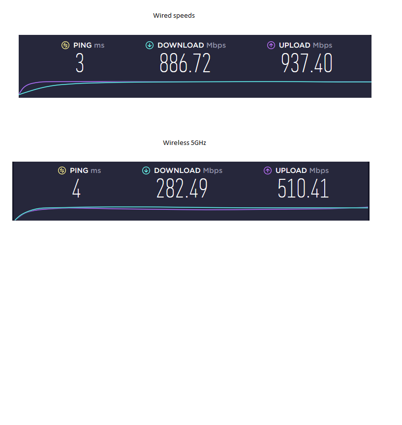

Hi i recently upgraded from 300mbps up/down to 1gig up/down and my ethernet is hitting 900+ up/down but my wifi 5ghz connection on my phone will only top out around 300-325mbps which is what it use to do when i had 300mbps Up/Down speeds its like my router still believes i had 300 meg but my wired connection is running fine... iv reset router and disabled QoS  and it doesnt change anything for wifi speeds still just 300ish, but my wired connection is fine, Im very annoyed with the operating system in the router DUMAS is slow and crowded.

  • That's correct, that puts the speed it's getting at about 660Mbps instead of what the speedtest is reporting. If speedtest was correct than you would only be able to download at ~33MB/s so I think you can ignore the speedtest results

      The screen shots from my test was done on my PC wired then switched to WIFI 5ghz have 2.4Ghz disabled, realized that it could be my phone so i eliminated that variable...

        How did you disable QoS exactly - by selecting Never or disabling it fully from the Congestion Control menu? What firmware version are you on currently? What browser/device are you using to access the interface?
