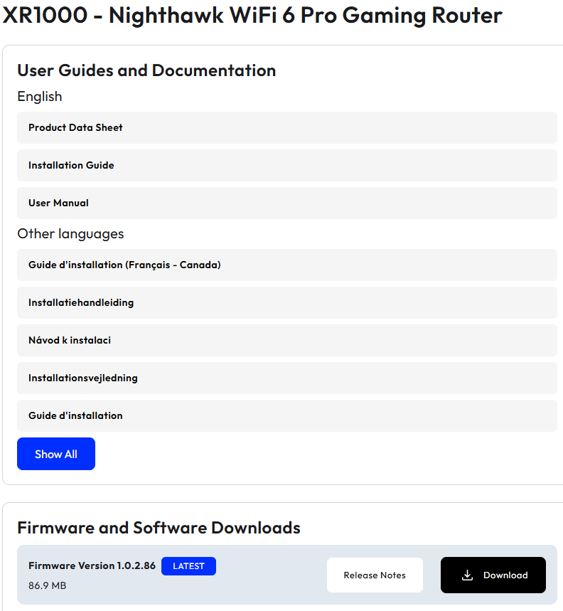

I have a XR1000 and my current firmware seems to be 1.0.64.18_5.0.19.
On the support page for the XR1000 under 'Firmware and Software Downloads' it says
"Firmware Version 1.0.2.86" with "Latest" next to it.
https://www.netgear.com/support/product/xr1000#download
Furthermore, I downloaded the XR1000-V1.0.2.86.zip, and when I extracted it, these are the files:
-XR1000-V1.0.2.86_2.1.40.chk
-XR1000-V1.0.2.86_Release_Notes.htm
According to 'Nighthawk Pro Gaming Router Model XR1000' user manual on page 151 it says
"Note: The correct firmware file uses an .img extension."
.chk files are usually recovery fragment files
What is the correct Firmware version and where can it be downloaded?
The latest is the one you downloaded and you upload the .chk file to the router on the firmware update page

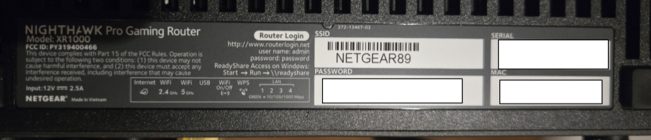

- plemansGuru - Experienced User
Is this an ISP supplied device? Or did you pick it up used?
Because that firmware matches the RCN version of the XR1000.
https://www.netgear.com/support/product/xr1000-1rnnas-rcn
- Netduma-FraserNetDuma Partner
