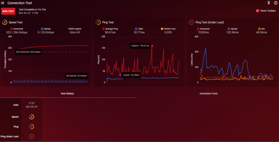

      However when I ran the bufferbloat test on another website I got a really bad "C" rating even though the entire point of buying this router was because it was recommended to solve that very problem when my previous router got an "A" but said it still had issues with bufferbloat. How could this one possibly be worse?
      Some of the numbers I'm seeing on the Connection Test don't even make sense for how bad they are. Like this router is somehow worse than the previous router I had even though this is supposed to have all the bells and whistles to fix things and my other router was much cheaper with less features.

        The online/offline won't stop happening, it's just for the reason I mentioned. The IP address was for the interface saying about reconnecting. I can't see your picture until it has been moderated but the results are from using a different provider and depending on what the server is they put you on your results may differ.
        Without changing anything you will get bad results, you need to adjust Congestion Control and run the test on the other site, keep experimenting with the percentages until you find what works the best.
