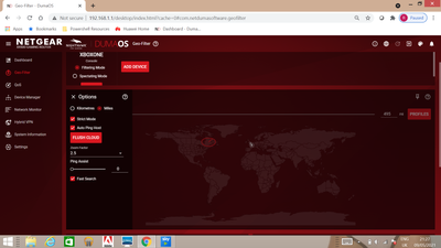

I bought the XR500 becasue of the Geo-filter capabilities, but I thought it would allow me to selectively adjust where I wish to connect to gaming servers, even if in another country.
However, I always seem to get connected to european servers no matter how I setup the filter. I am in the UK, but I want to connect to USA servers.
I use XBox Console, playing Call of Duty and I set radius over East US with 500 mile range, Strict Mode is On, Ping assist is set high to allow for the distance, but every server or peer I connect to seems to be showing on the map as in Europe. I've tried with Fast Search on and off. I do get connected to games, but not where I have set the filter radius.

- Netduma-FraserNetDuma PartnerYou will need to set Ping Assist to 0, that is how you force servers in another country, otherwise it may get you games closer to home.
