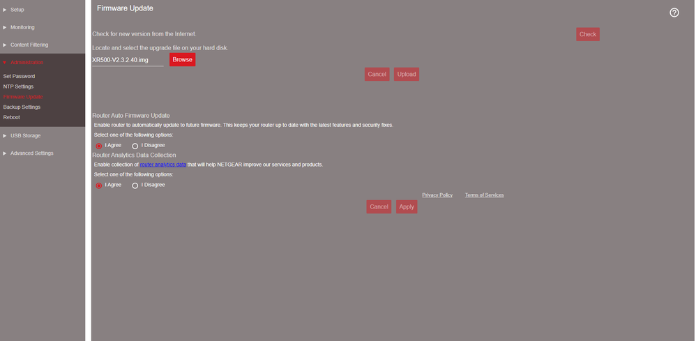

Hey all,
This is the second time I've encountered this issue, the odd thing is this time I can't resolve it myself.
I'm getting the dreaded "DumaOS not loaded yet" message.
DumaOS not loading
I went to routerlogin.net to resolve the firmware and rollback to the previous version. However, when I try and upload the firmare the cancel/upload buttons are blocked from being pressed. I tried several different browsers and have the same problem with each...
I was able to work around this by selecting the filename and pressing enter to which the firmware beigns uploading... However, I encounter another screen after the upload that states the firmware is older than the current do I wish to continue, to which I cannot press enter and the same button issue is present. I'm stuck here, I've tried just about everything.
Firmware buttons locked
Any insight is much appreciated.
  • The easiest thing to do would be a factory reset as that should resolve it immediately, does that work?

      That did the trick! Thank you for the response.
      It's a blessing that I had backed up my settings only a week or so ago! Must have preemptively had known lol. So a reset, update, and then a settings restore solved the issue.
