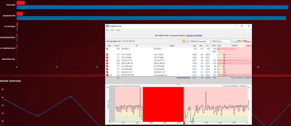

XR500 QoS works on my device but not on others in the network
Greetings,
I've had the xr500 for a while and it helped tremendously to reduce my lag spikes, but lately they started coming back so I started investigating.
My sliders are set to 85% down (40Mb) and 75% up (10Mb), and as I said QoS used to work flawlessly, and it still does on my device (tested with various speedtests, which maxed out at around 35/9 and didn't cause any increase in ping). But for some reason when the spikes are happening Network Monitor shows a family member's Mac using all 13Mb of upload, completely disregarding my settings.
I tried a reboot as you can see in the image, but it didn't help at all. For reference, I usually hover around 10ms.

  • I assume that you have Anti-Bufferbloat/Congestion Control set to Always? What network activity is the Mac doing when you notice this behavior? Uploading photos etc? Is it torrenting (legal files of course) by any chance? Do you have the Mac added to Traffic Prioritization? If not do you notice high priority traffic being detected when the Mac is used?

      I'm not sure but Network Manager says Web -> Google. Would that even make a difference? Isn't it supposed to always restrict speed?
      No, the only priotized things are DumaOS classified games.
      Yes, I did notice high priority traffic being detected even tho I didn't have any games open at the time.

        It would appear that whatever the Mac is doing is being categorised as high priority traffic by mistake, as such it's then superseeding the limitations set in Congesiton Control and using full bandwidth. If you can let us know exactly what the Mac is doing at this time, we should be able to work out what's incorrectly categorised.
        To verify this, disable DumaOS classified games and make a new rule for the device you game on. For the time being, just select a basic config profile for whatever game you're playing (if applicable) and that should solve the problem.
