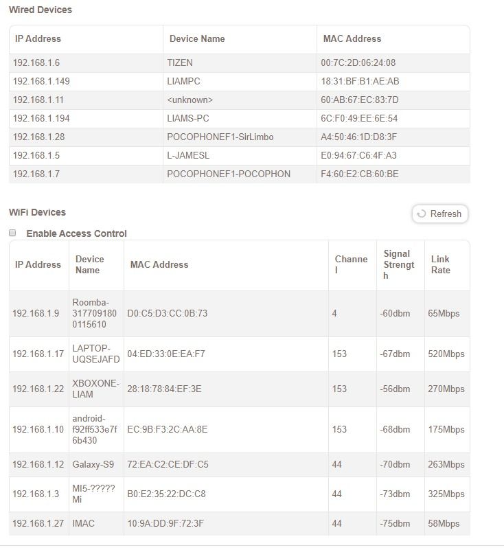

I recently revived an Imac. The Wifi network card that is uses is a Atheros 9380.
The extender is connected via an ethernet cable.
When the imac is near the Xr500 I can only get speed up to 100Mbps.
If I take the Imac and place it next to the EX7700 the speed is at 250Mbps.
My phone gets 600Mbps next to the router.
Why is there such a speed difference between the router and the extender on the Imac
The Imac is running High Sierra
Thank you
James

  • That shows my devices. My phones show as wired?
