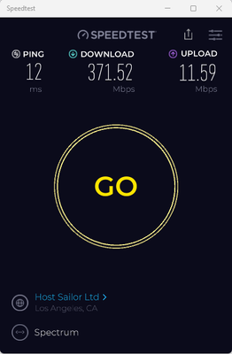

      My comment (above) remains the same.  It is a bit frustrating (annoying?) that the version of Ookla Speed Test included in the Orbi firmware does not report the Speed Test server that was used:
      Whereas the Windows Speed Test app clearly shows that it was using Host Sailor Ltd in Los Angeles.
      Did both tests run against the same Speed Test server?  No idea.
